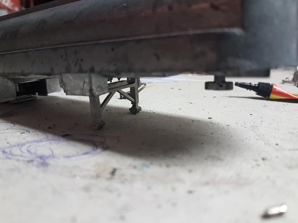

    spray painted the wheels
    and remove te Original landinglegs system and replace them for a more realistic model.
    not mouted them yet,the model is not on it's wheels,so don't know the exact hight for them.
    also made a ladder for the tanktrailer,also not glued yet. it will give problem for the spray paint
